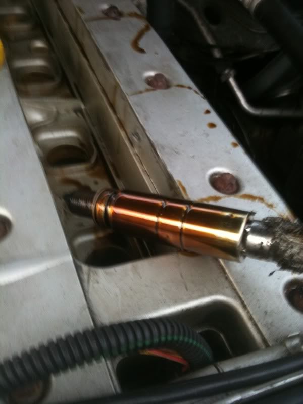

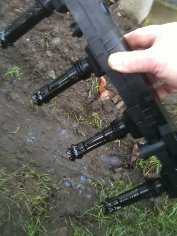

Right, where to start
Taken plug assembly out
Oil was pouring off  :-?
Took number 1 plug out (nearest to bumper)
At least 2 inch of oil  :o
The spark plug its self is ok, but yes i'll change them once oil problem sorted
Any suggestions  :-?

I hope you drained the oil out of the well before you removed the plug?  :o
Cam cover gasket needs changing, easy peasy job on the desmond but make sure you use the genuine seal and o rings with the black sealant :y

Well i got as much out with a rag the best i could b4 taking the plug out. What happens to the oil, i take it drains somewhere but will cause problems later ???
Thanks for quick reply  :y
2.2 petrol GLS estate
Re: Jobs and problems
« Reply #9 on: 01 January 2011, 15:04:16 »
Well i got as much out with a rag the best i could b4 taking the plug out. What happens to the oil, i take it drains somewhere but will cause problems later ???Thanks for quick reply  :y
Into the combustion chambers of the engine - be prepared for lots of blue smoke from exhaust for a while on start up
