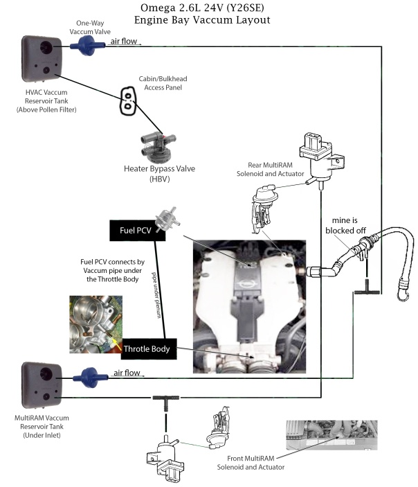

Hi All,
New to posting in the forum, but... been reading for years...
Turns out all the posted vacuum diagrams are not accurate for 2.6L (No IAS, EGR...), and as I struggled with my 2002 2.6L Omega I decided to try and share an easy to read and CORRECT diagram for the vacuum lines:
Will be happy to share more of the experience fixing my vacuum setup.
Eyal
« Last Edit: 30 August 2021, 00:12:50 by Eyal2002 »

The double T on the non return valve is the wrong one for the 2.6/3.2.
It should only have a single T.  ;)

Oh? can you please elaborate? can you please offer a drawing?
My latest mechanic did not know how to even approach the multiram and the vacuum, not to mention both solenoid were broken. I read hundreds of posts in OOF only to realize all are describing a non 2.6 engine. The only drawing I found with two vacuum reservoirs did not fully match my engine (IAS, FPR...), so I deduced and then sat on photoshop, then fixed the solenoid, bought new vacuum lines, and searched many pet shops tull I found descent check valves for the reservoirs.
I will be more than happy to see what I drew or did wrong, also im PM.
