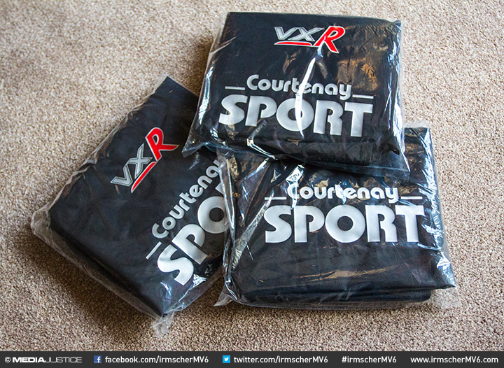

Courtenay Sport protective seat covers. Each one adds at least 20bhp to the host vehicle. That's 5bhp more than if they had 'Regal' printed on them.
