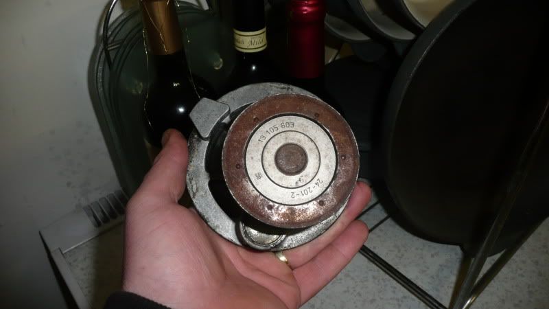

heres the old one9i had tried the baring and it was fine ,but when i took the old one out :-(
as u can se looks fine

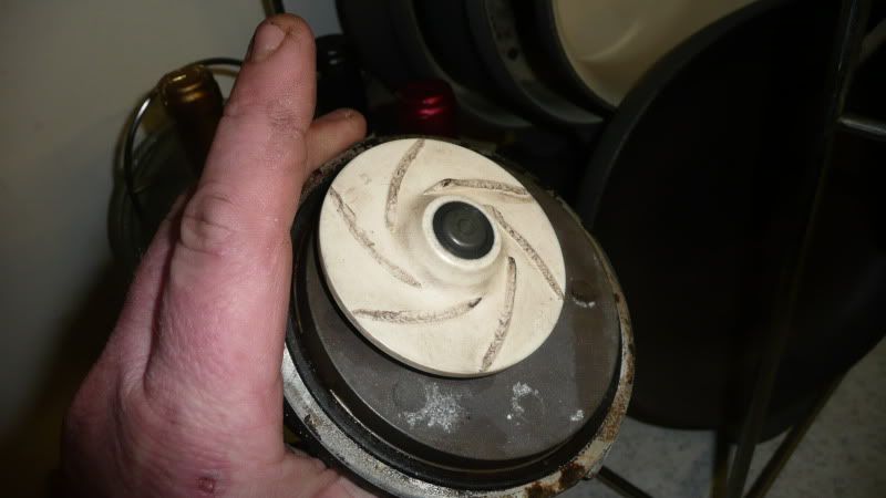

then you look at the other side  >:( :( :o >:( :(
all the fu...ng fines are missing!!!!!!!!!!!!!!!
that def explains all the probs ive been having!!!!!!! def not a knackered temp gauge when it said it was hot it WAS!!!
thing is why has it done this??????i spent 2 hrs taking all the pipes off looking for the fines,there should be 6 but i only found 3 :-( dont no where they are but there not in the pipes,rad or the head enless there in the block?,ive pumped as much high preasure water throwe it as i can but cant fined the other 3 fines  :o :o :o :o :o

"Why has it done this?"
My best guess would be that you had a freeze-up at some point and that was trying to pump ice/slush, which it isn't going to do well at.

That impeller, or what's left of it, looks very like the OE BMW one that I took off my car. I hope that your new one is a bit more robust. :y :y :y

as for the new water pump,YES the fans on it look about 3 times thicker than on the old one,hopefully they will not fall off lol
