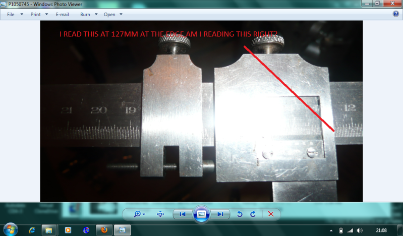

hi there
do you mean i need a better one? ie electronic ? im sure no one could have skimmed 7 mm off it surly if they had the engine would not have worked???
do you no if theres a min marker on the head some where???
cheers for your help mate ,this is worring me now lol
cheers
griff
Andy B
  • Bury Lancs
  • Posts: 39909
    • ML350 TDM SmartRoadster
Re: no idea hopefully someone can help?
« Reply #91 on: 09 January 2011, 20:59:45 »
hi there
cheers
griff
 ;D you're using a vernier, often referred to as a very-near because the reading is open to interpretation. A micrometer looks like ....
and is considered more accurate.
I'd say it was impossible for 7mm to have been machined from your cylinder head. Either the 134mm quoted isn't right or you're reading your vernier wrong!  ;) ;) ;) hence me asking for a picture without the flash  :y :y
Min marker? I've never ever looked for a min marker but doubt there is one only because the difference between a new head & a min thickness head is only usually a fag packet thickness, so the marker would be as wide as the maximum you're allowed to skim from it.

« Reply #92 on: 09 January 2011, 21:06:21 »
never used one.. but the reading of 126-7 looks like from the edde(right hand side of the piccy) :-/
Andy B
  • Bury Lancs
  • Posts: 39909
« Reply #93 on: 09 January 2011, 21:14:03 »
None of mine have a window on them and you line a zero mark up on the sliding bit with the graduations of the fixed scale. Either that or the easy way of a digital vernier ......, especially as your arms get shorter!  ::) ::) ::)
griff2494
  • fallingbostal,germany
  • Posts: 135
« Reply #94 on: 09 January 2011, 21:14:46 »
CHEERS FOR THE REPLY
ive tried to take pics with and without a flash both are hard to see but this seems best
im reading it 127mm at the edge enless im reading it wrong? first time ive ever used it lol

Andy B
  • Bury Lancs
  • Posts: 39909
« Reply #96 on: 09 January 2011, 21:18:57 »
have you got a zero mark on your scale inside the window? I take it scale reads from zero to 25 or 5010 (I'm getting mixed up with a metric & imp micrometer thimble ::))  :-/
If you have, that's what you're lining up with against the fixed scale.
Have you got a normal rule you can use? You'll be able to measure within 1/2mm with that, certainly within 7mm  :y :y :y

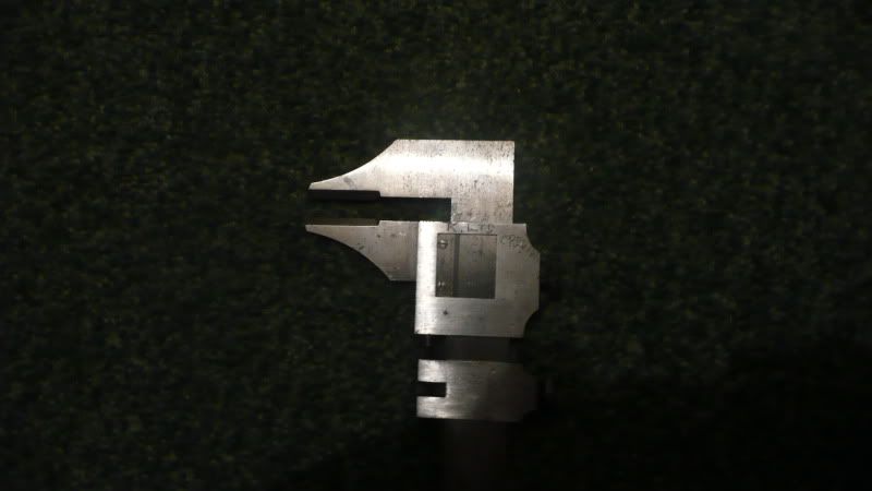

griff2494
  • Posts: 135
« Reply #98 on: 09 January 2011, 21:24:51 »
now im pissed off!!! made myself look stupid!!!!
think i will just throw this measuring thing in the bin!!!!!!
heres why if you look below you can see on the pic that when set to 0 the jaws are miles apart total waste on money!!!!!!!
god do i feel silly now!!!!!!!!!!
Andy B
  • Bury Lancs
  • Posts: 39909
« Reply #99 on: 09 January 2011, 21:36:48 »
You're reading it wrong. When the jaws are closed the zero on the fixed scale will line up with the zero inside the window.  :y :y :y

griff2494
  • Posts: 135
« Reply #101 on: 09 January 2011, 21:39:58 »
cheers andy b
now i feel even more silly!!!!!! after wot you put i reread and guess what ???
yep you guest it 134mm !!!!!! DOH!!!!!!
