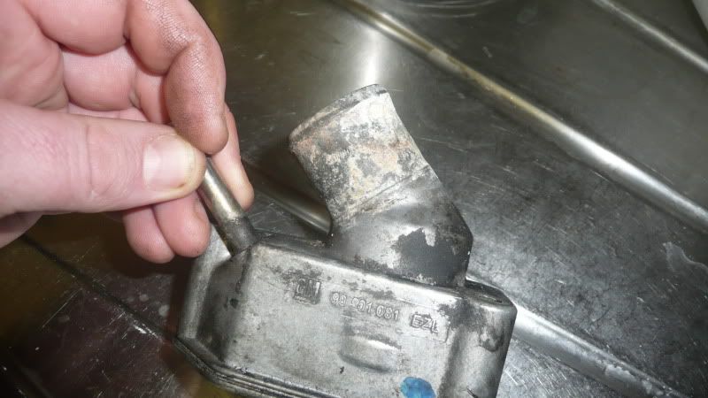

well a few items arrived today :-) (well yesterday lol)

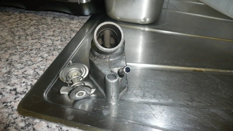

got my cam cover gasket and thermostat

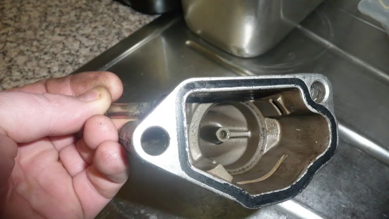

went out to change the theromstat + housing
removed the old one that was showing signs of leaking
as you can see the crust where its been leaking ,i would say for some time too!!!!
took the old thermostat out
took it out boiled it and nothing !!!! its def not working,did not open even at boiling piont
also who ever changed it last time just put loads of loctite on it which you can see even in the housing,bet it also gone in the engine :-(
anyway fitted the new one,no more dripping but the heating still not working,even the pipes going to the heater dont heat up !!! AIR LOCK MAYBE ???//

i assume that seeing the thermostat did not open /not work that could explain why she got so hot!
also the leak on the housing could be why the water loose,and once i change the hbv i assume then all routes are covered as for water loose as no pipes are split

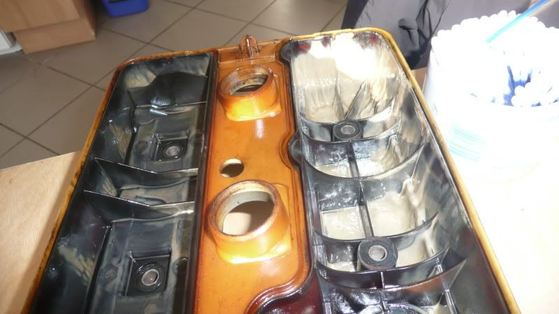

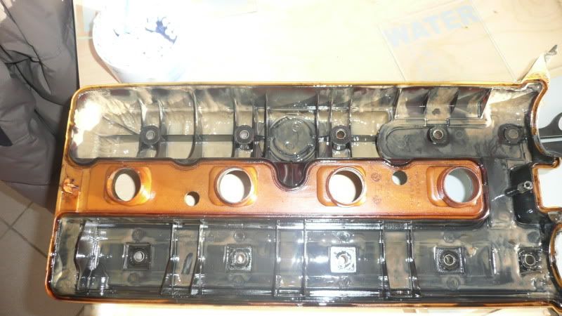

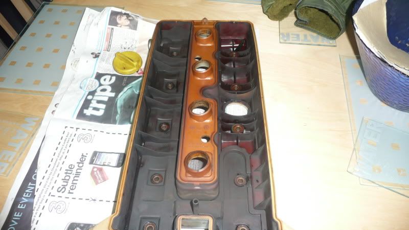

thought i would tackle the cam cover/rocker gasket
im sure someone before me must have done this before as the bolts where not tight! (not sure of the torque settings they should be but they where just tighter than finger tight)
anyway took it off to find this
i expected to see some mayo seeing i was told that is quite normal for a car of this age (2002) that just does short journeys,but not this much ! esp seeing when i did the breather pipes before they where covered to
but still theres no sign of mayo on the dip stick!!!!
ive looked down into the pots like was advised to ,to see if i could see any water/antifreeze on the pots after she had been ran then cold but i cant see any  :-? so still not sure if its the hg
whats everyones opion
cheers griff
ps next is to clean the mayo from the rocker cover then get it throw the dish washer  ;) (while wifes shopping lol)

now im even more confused!!!!!!!!!!!

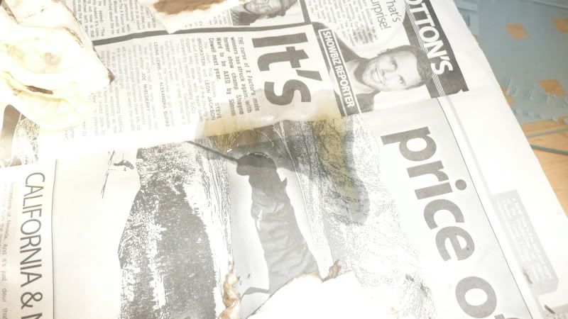

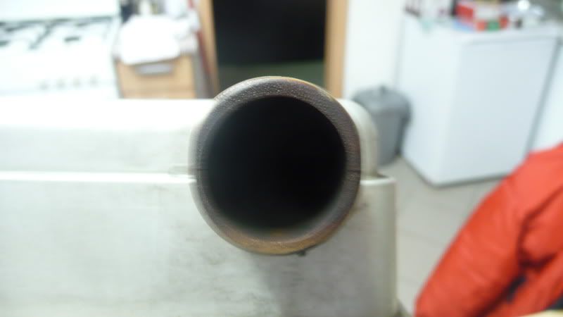

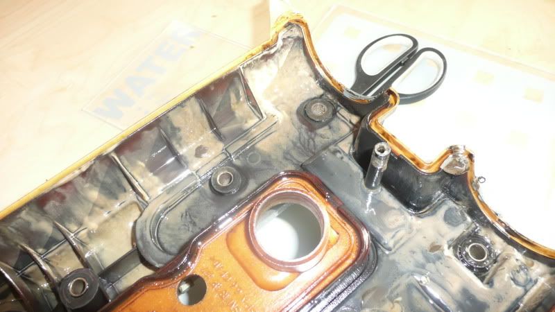

when i started to clean the mayo out ,i turned the rocker cover on its end so the 2 breather pipe holes faced the table and this happened
water ran out of it all over the news paper  :o :-? :-? :-?
but i dont under stand
1. that much water!!!!
2. its clear water!!! has no antifreeze in it  :-? :-?
i had to get a bowl in the end
like i said thing is it has no antifreeze in it its clear  :-? :-?also how can it of got there???????surly that much water if it was from hg the engine would not work and the rocker would be jammed packed with mayo
also does the rocker cover come apart? ie where the breathers are it looks like some kind of cover ,but i dare not start pulling at it incase it should not come apart

Don't worry about the mayo and the water.
What many people don't appreciate is that when you burn hydrocarbons like petrol and diesel, the reaction produces primarily carbon dioxide and water.  The carbons combine with oxygen to form CO2, the hydrogens combine with oxygen to form H20.
This is why steam comes out of exhaust pipes (all the time, but usually only visible when the exhaust system is cold), and why crankcase ventilation fumes contain significant amounts of water/steam, via blowby past the piston rings.
If you only do short journeys, this moisture in the crankcase and breather system may build up, as the whole engine isn't hot enough for long enough to evaporate this stuff out.   :)
And the reason why you should just drive the car rather than have it idling for ages ages on the drive.

well wife came back so could not use the dish washer :-(
but she was still pissed off when i took it in the shower pmsl
but much better know ,now mayo
,and also got all the crap out off the hard to reach places lol
all breather ports sorted,clean inside and out :-)
i used to have a vauxhall carlton and it had some kind of blocks of mesh in the rocker cover that acted as a filter they where so much easyier to clean than this set up on the omega
