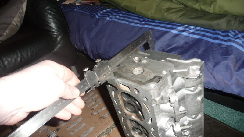

The does look a but close, it was a while since I did mine so I cant remember the clearance.  If you dont want to get it skimmed maybe you can get a metal ruler and some feeler blades to see if it is warped.
edit: is that valve properly seated there?  Besides once you grind the valves in they will sit marginally lower

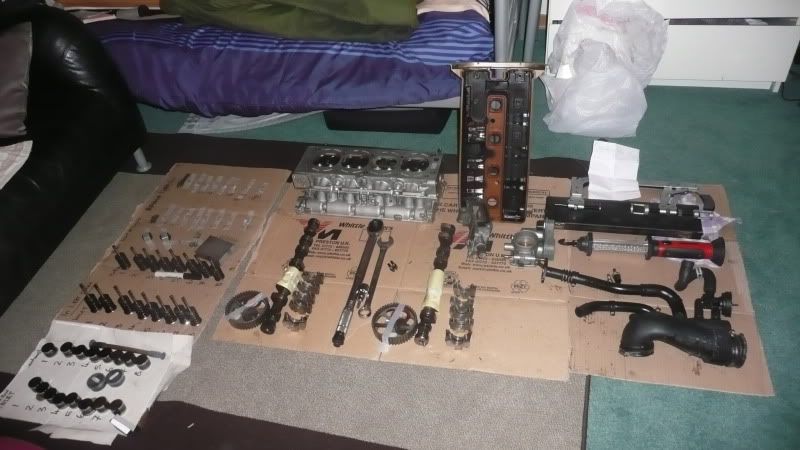

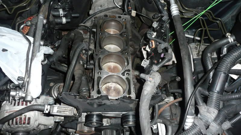

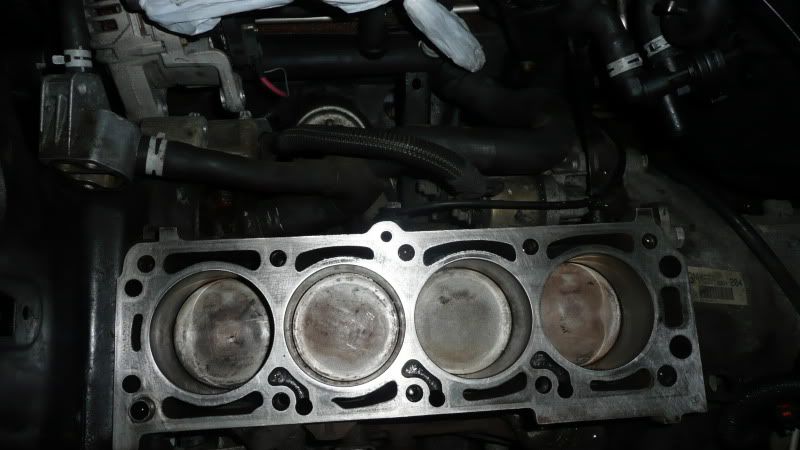

next was to clean the block,got my scraper and nipped to get some petrol to get it crystal clean!!!!
also gave the pots a good clean (not with scaper lol just petrol,cloth and plenty of elbow grease lol)
happy with that :-) only took about 30mins :-)
so thats every thing cleaned (all mayo gone) labled (so goes back just where it should)
 and as soon as the hg kit arrives (and i get a day off ) will all be put back together and hopefully that will be all the probs sorted :-) well apart from the cracked exhaust manifold but that will have to wait till next pay day lol

and no when i took the pic of the 1 valve sat in the head it was not sat correctly ie its not ground back in yet nore did it have the spring connected,cant do that till hg kit arrives and i get the new oil stem seals

as you can see on the above pics of the block,the pistons do NOT have indents for the valves,they do curve at the edges but weather this is enought to miss the valves if i get the head skimmed im not sure :-(

« Reply #87 on: 09 January 2011, 20:40:37 »
erm now im all :-(
after the post ref thickness on the head 134mm
im very :-(

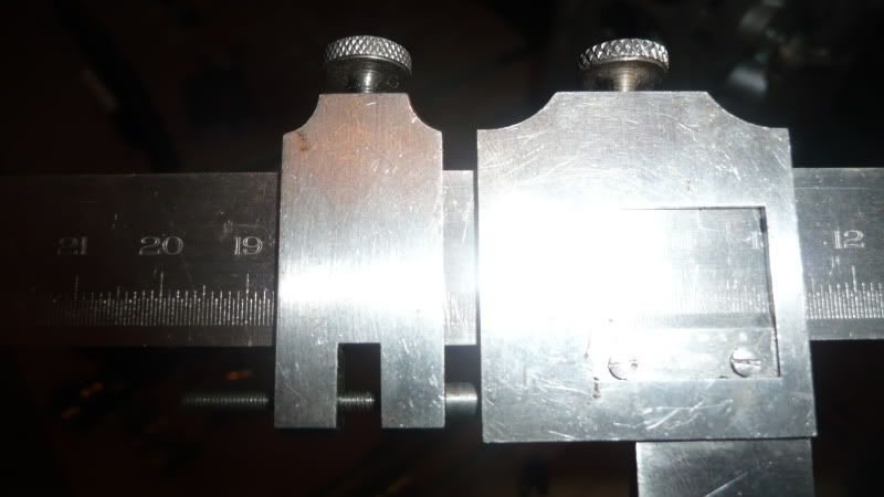

just got the micrometre out and heres the results ,im confussed as the car ran ok
its reading !!!!!!!!!!!!!!!!!  127 mm !!!!!!!!!!!!!!!!!!!!
that means its had 7mm skimmed in the past !! that cant be righ!!!!!!!!!!!!
any ideas
i really need to no if theres a min marker somewhere on the 2.2 head!!!

just got the micrometre out and v......v
That's a vernier aka a very-near  ;) ;) ;) ;)
  • Posts: 39909
Re: no idea hopefully someone can help?
« Reply #89 on: 09 January 2011, 20:50:38 »
see if you can take another piccy without the flash.
It's too difficult to read due to the flash.  :y
