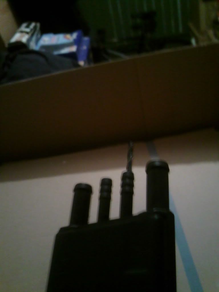

Ok kids, here we go....
Tonight I got a rare couple of hours to myself in addition to coming home for lunch. So, I started cleaning my plenum, breather bridge and throttle body.
Just really wanting to know what you think. I can definitely get more gook out (which I will do) but just wanted to know if it would be ok if I left it as is. Here are the piccies......
Ok firstly there's this pic... this is a 3-4 inch drill bit. The pic shows the drill bit as far as I can get it in. I did attach it to my drill and give it a few whizzes round. The amount of shite that came out was grim!!! Now, it does this also for the other tube next to it. I'm thinking maybe this stops due to the circle bit on top. Or should i just go nuts with the drill? The circle with the 4 tiny holes cleaned up real well.....

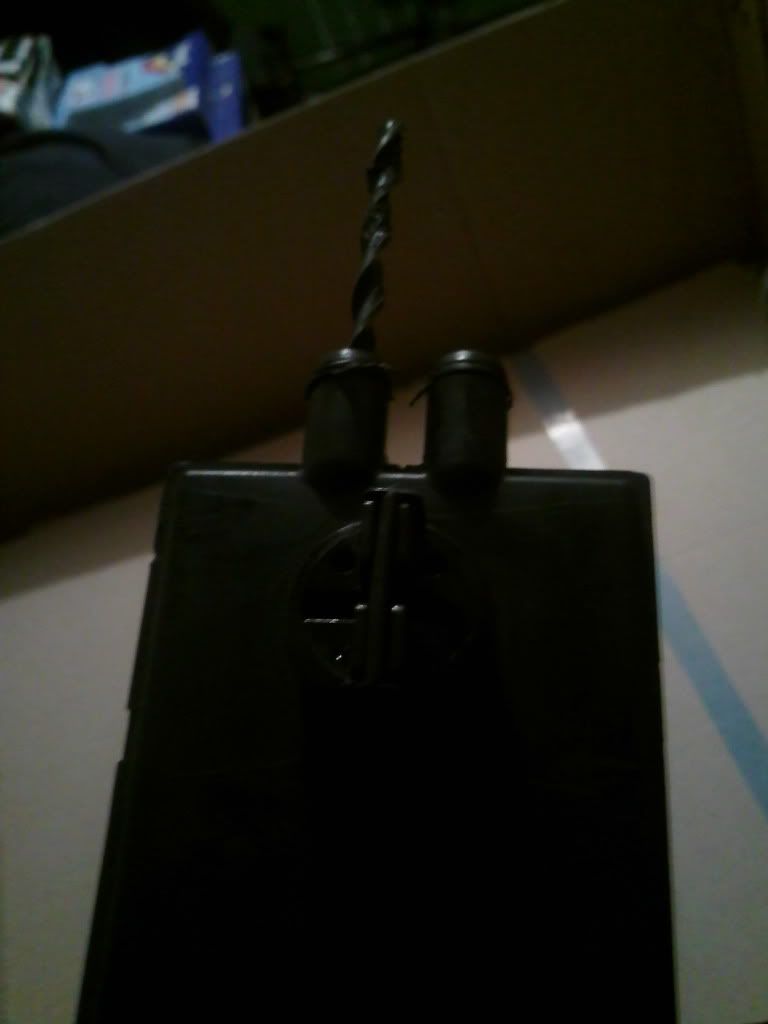

Second pic. The other end of the breather bridge. I can get the thin drill bit all the way in. When I blow carb cleaner through the 2 big pipes (pic 1) the only ones the cleaner shoots out of is the two bigger pipes on the end. Is this normal? Should I be using force to make more headway??? I'm guessing that the two thinner ones inside go through that circle bit with the tiny holes hence why it doesn't shoot out of these?.......

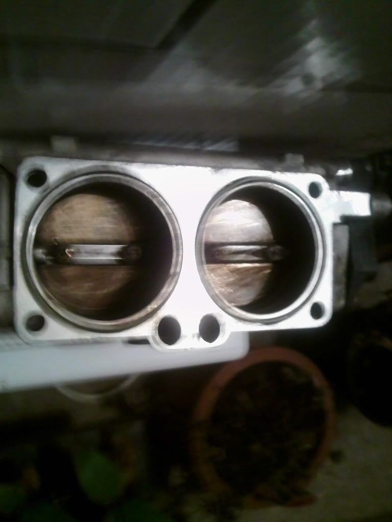

Pic 3. The throttle body. I've cleaned them pretty well I think paying special attention to the edges of the butterflies. There's still a little bit of shit but it's going to take a lot of elobow grease. I will obviously do it but is it worth getting them any cleaner? Your thoughts appreciated.....

Don't forget the pipework, esp the 'Y' one, and the holes in the breather box at the back.
Shame you haven't got access to a compressor, the sludge can't stand 35psi air pressure for long  :y

Bung all holes up of one end of that plastic breather up and fill with cleaner / leave over night . That should shift it , dont drill into it .
Connecting rubber pipes / de gunk them as well or wont be worth you cleaning the bit you have showed unless you have cleaned them already  :y Nice job on the throttle body , looks clean enough  :y

Cant remember off hand about the breather , i took mine off and it was clean on this car so just spray cleaned with gunk and it flowed straight through ... i dont think you can push anything straight through ...could be wrong  :-\ been a while since i un blocked one that was that bad  :y
