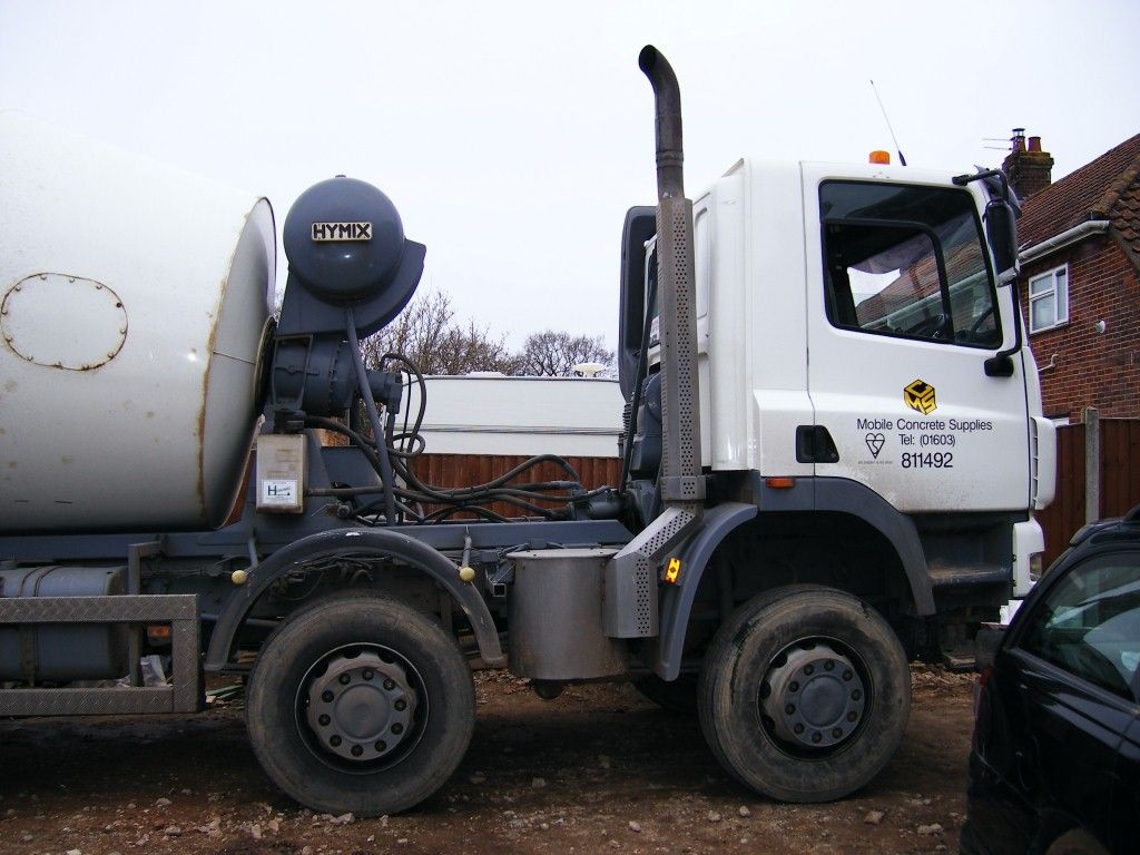

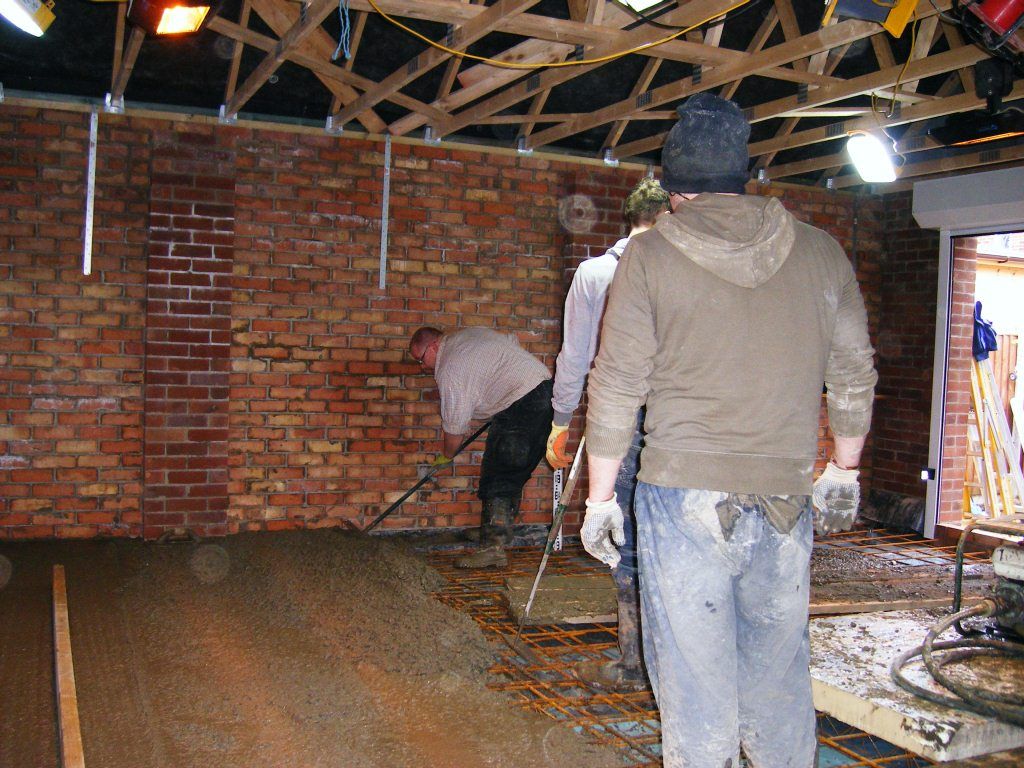

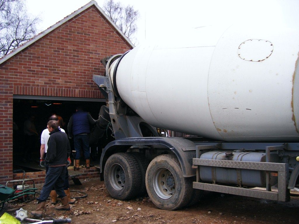

Everyone arrived between 7 and 8am, and we completed laying the steel mesh on chairs, and tying everything together. At 9am, I had to squeeze this down my drive!  The first of 2...
This truck holds 8m3 of concrete, so the plan was to get that all in the garage, then for it to reload and return with another 8m3 to finish the garage and then do the 2 bays.

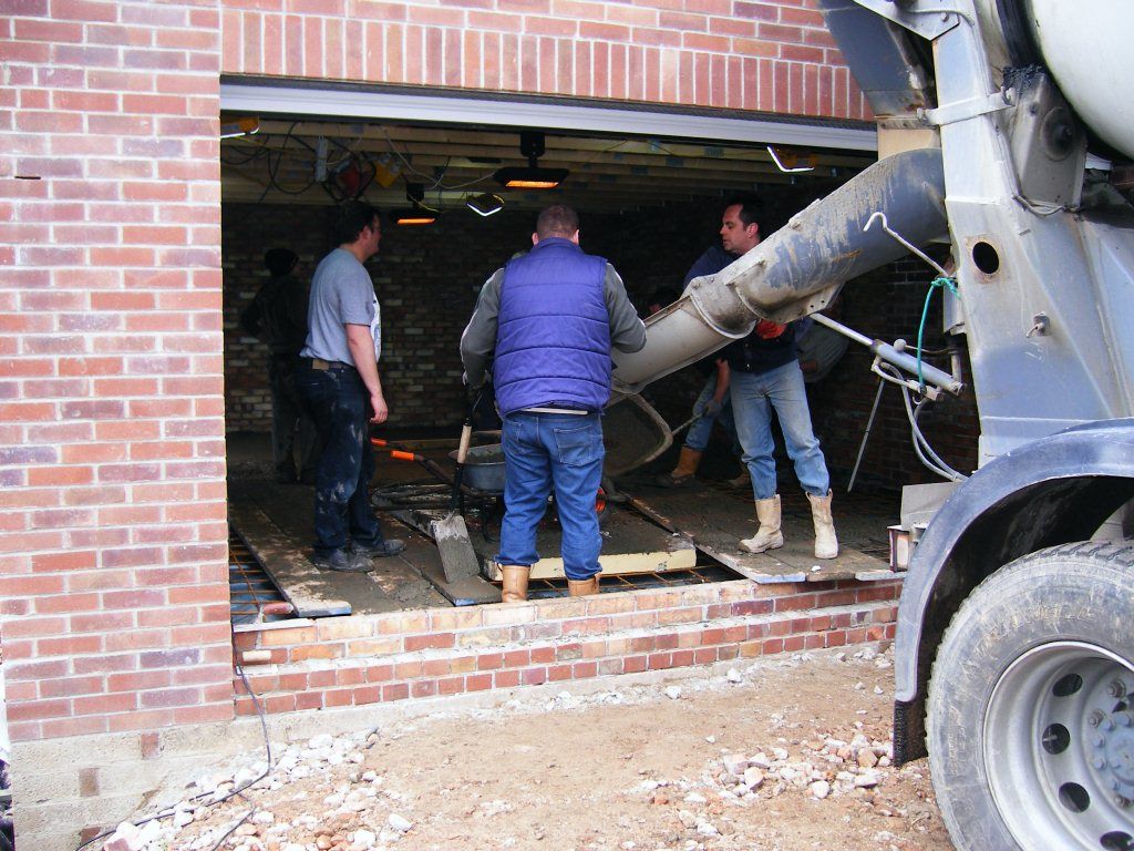

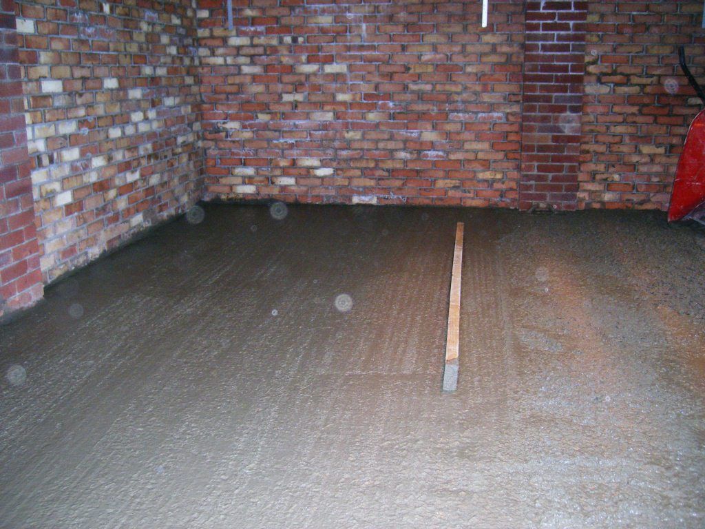

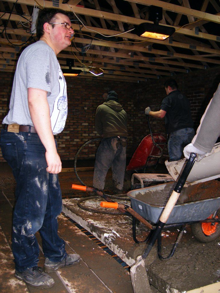

So where are a couple of pics showing the the concrete going down in the garage...

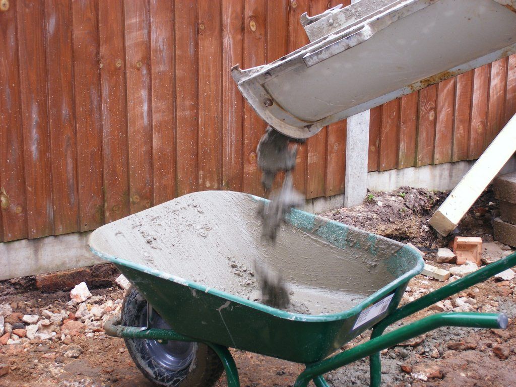

Man I got sick of the sight of this...  ::)
Coming along nicely...  :y

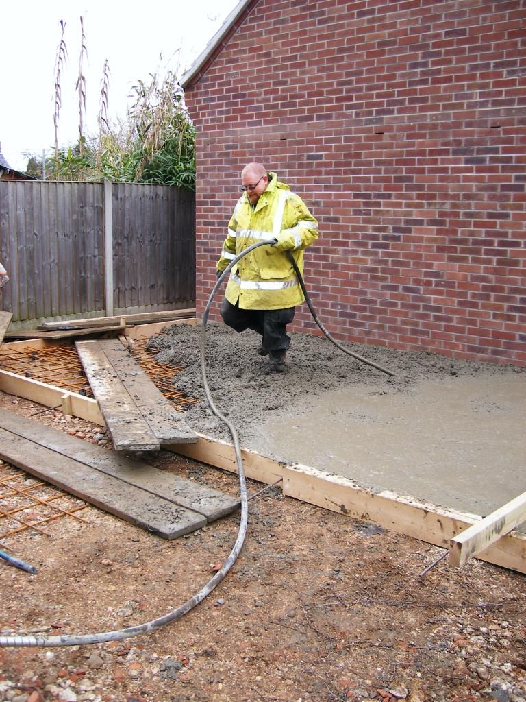

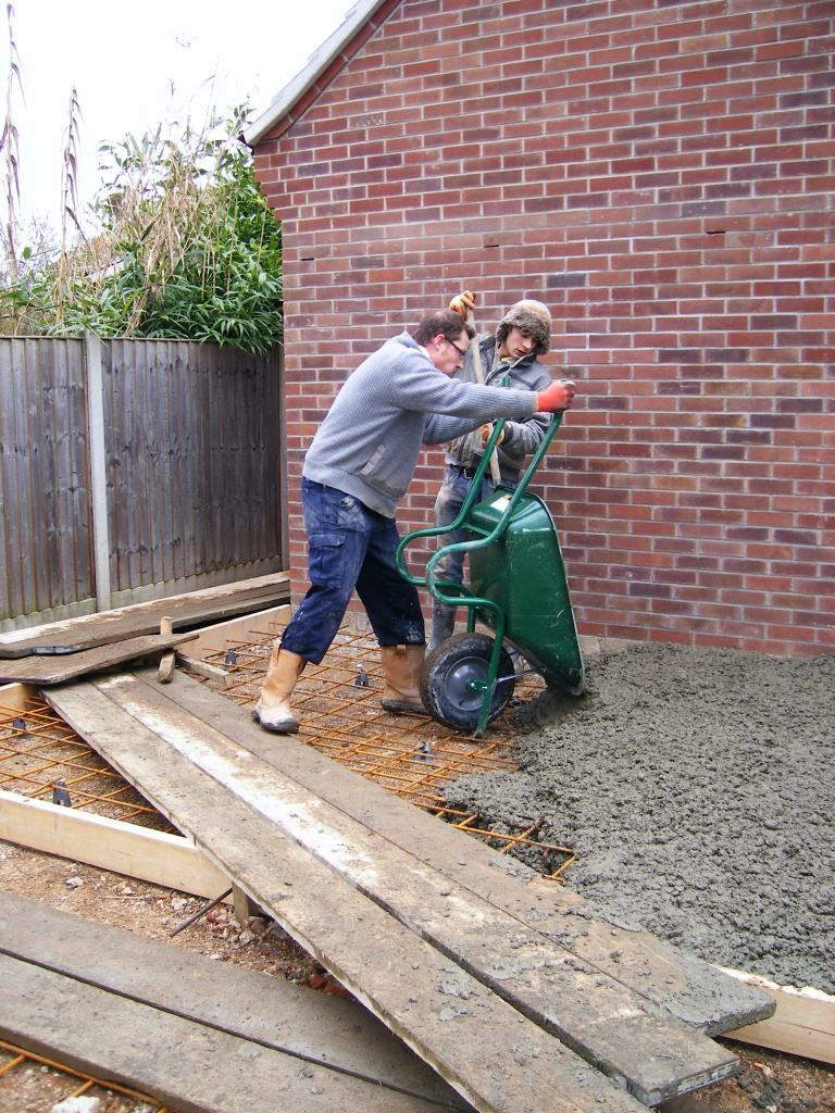

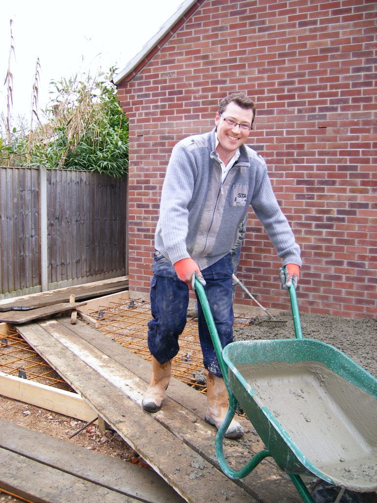

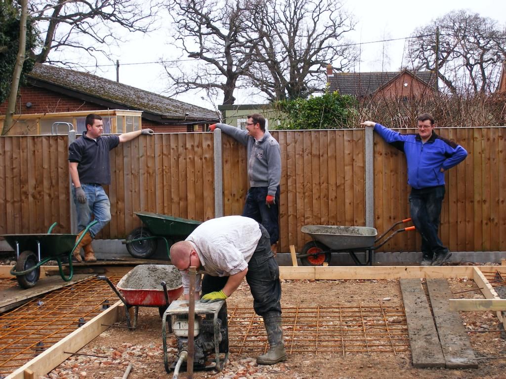

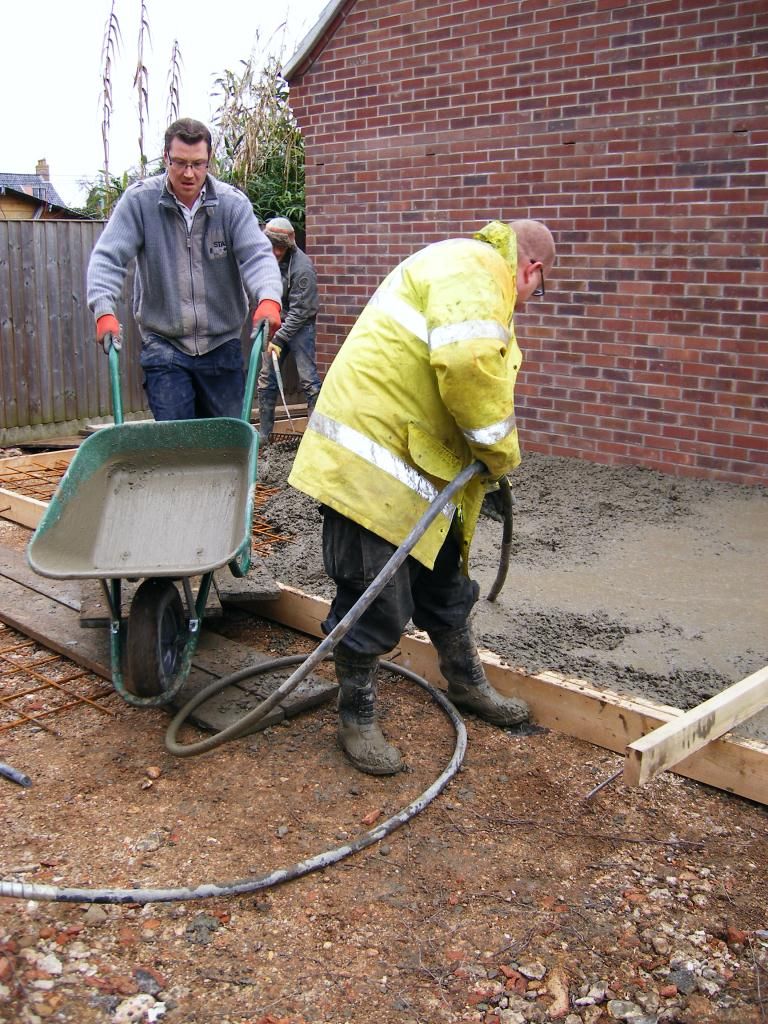

So then it was time to crack on with the bays...
For those of you who don't know, this is me...

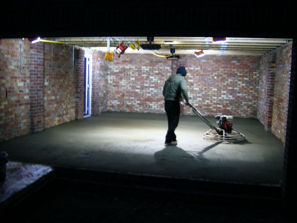

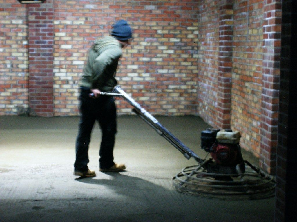

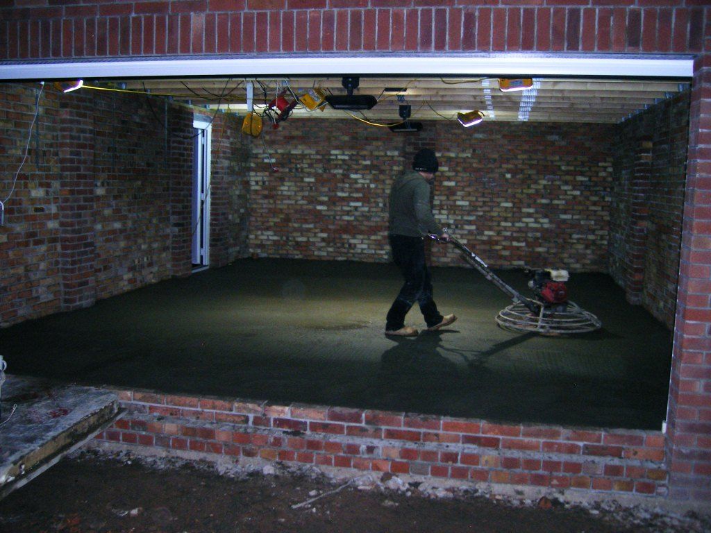

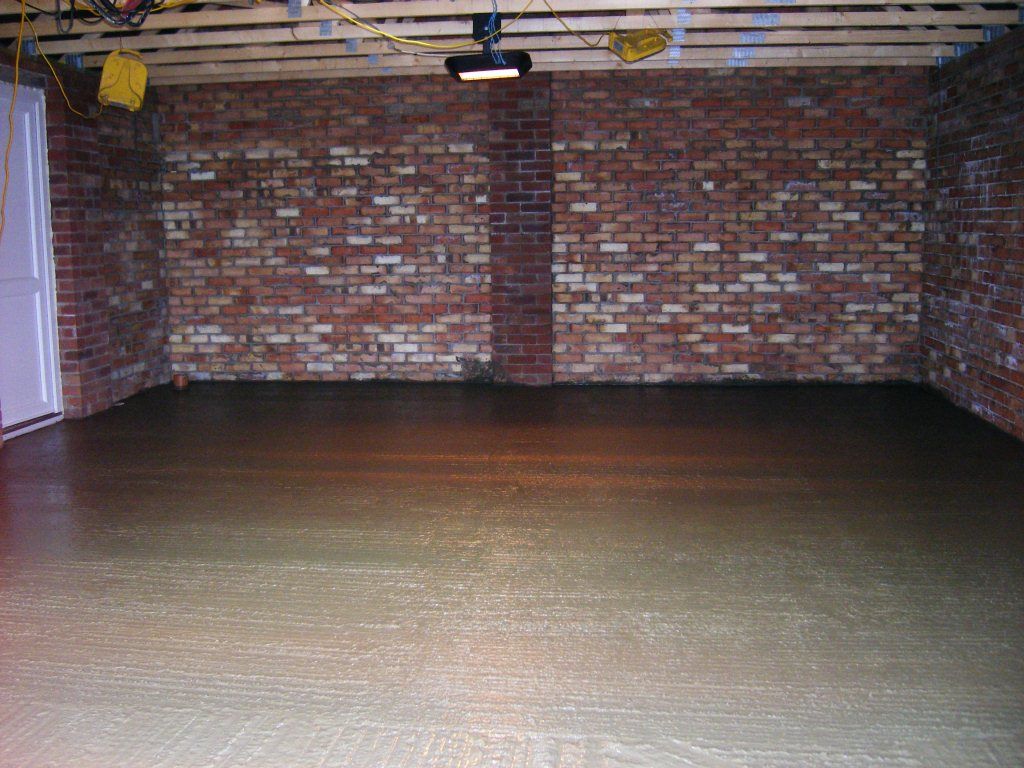

These last shots show the powerfloating of the floor going on, which went on way into the night.  We finished at about midnight, so a very long day!!

Great job of holding that fence up twigs. ;) ;D
Looking good though. :y

Looking good now, when does Eddie Stobart start using this depot?
It's a heavy fence!  It took 3 of us!  ;D
Oh the neighbours would love that Andy!  ;D

Someone wasn't looking (or able to) when that was backed up the drive, looks quite close to the garage :o
Take it the machine in the last pics effectively smooths and levels the concrete like a sort of floor polisher :-\
I reckon you'll be in by Easter 8)
I backed him up the drive myself Al.  He's about 6 inches from the garage, which is where I wanted him.  The further I could get the shute into garage, the less barrow work I needed.  :y
The machine is a powerfloater.  You use it whan the concrete is almost set and like you say, it takes out any surface imperfections left by the tamper.  It leaves a very smooth surface, and also eliminates the usual dust that you get everytime you sweep a normal concrete floor.  :y
