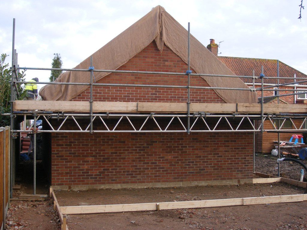

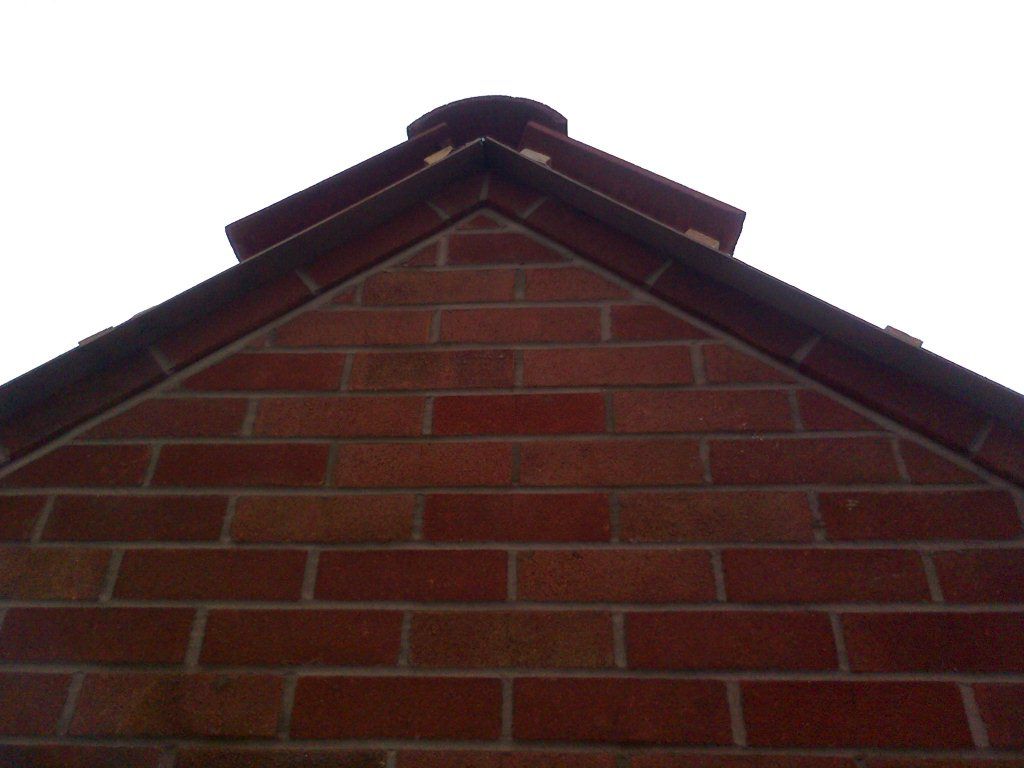

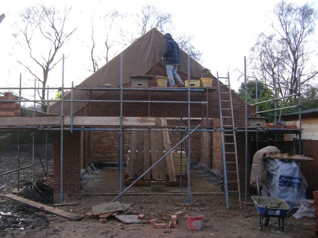

The brickies came back to complete the gables, and a fantastic job the did too.  I'm really chuffed with the quality and finish of the brickwork, with cut gables to tie in with the detail on the house.  The rear gable is a single skin with a centra pier, and the front is double skinned with lightweight blockwork for the internal skin...
More to come...  :y

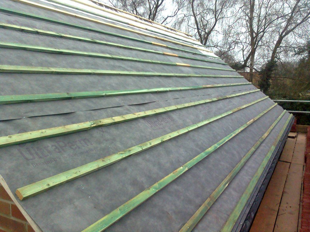

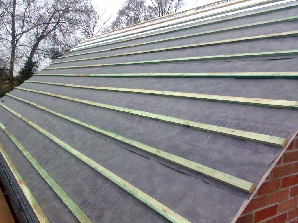

Then it was back to me to get the roof felted and batterned.  I've used Tyvex breathable roofing felt, and 2" x 1" batterns for this job...

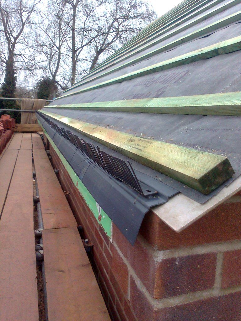

There's quite a bit of thought needed to get all detailling right here.  I've used 6" UPVC fascias and soffits, that sit perfectly with the corbels, and will allow the gutting to fit nicely.  I've used 4" cement boards for the verges, giving a 2" overhang.  I've also used plastic soffit trays and bird combs, as shown in the next picture, as I want this roof to last for many years without having to revisit it...
