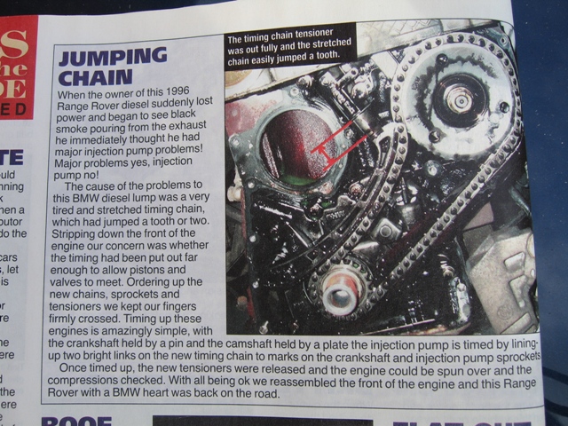

« Reply #295 on: 28 August 2007, 12:19:46 »
have now consulted the oracle..... pump is matched to original cars ecu requires attention from b%w to rematch. three options a, change pump so that your original pump is back on the engine or b, change head and reinstall original engine or c, bend over and take some from bmw :( :(
Read that on the BMW TIS, seems that only affected early ECUs (ie, a new pump needed the ECU to be upgraded) is my understanding....
Omegatoy has just popped round with further info - something that I did consider last night, hence swapping heads and engines....
Picture to follow...
  • Posts: 108105
Re: Project Tractor engine swap
« Reply #296 on: 28 August 2007, 12:24:38 »
Could this be same thing?
  • Posts: 108105
« Reply #297 on: 28 August 2007, 12:27:29 »
So, whats easier/cheaper - changing chains/spockets/guides or changing heads over and swapping engines back?
Or worth changing pump first? Bit loathed to do that, as I have a working block with pump all timed, just needs head fixed?

« Reply #298 on: 28 August 2007, 12:36:08 »
I think you might be better just having a look at the chain etc first before you swap anything else.
Did you hear it running before?
Maybe you would be better off pulling it out and fully rebuilding it?
Sorry, I know it's hard to take on board the worst case scenario but in reality in may be quicker to do and you should see 100k before you get an oil leak.  :y
RonaldMcBurger
« Reply #299 on: 28 August 2007, 12:37:55 »
Both nightmare jobs. Either way, you have to take timing chain off, so my bet is scrap it and call it a day. :(
