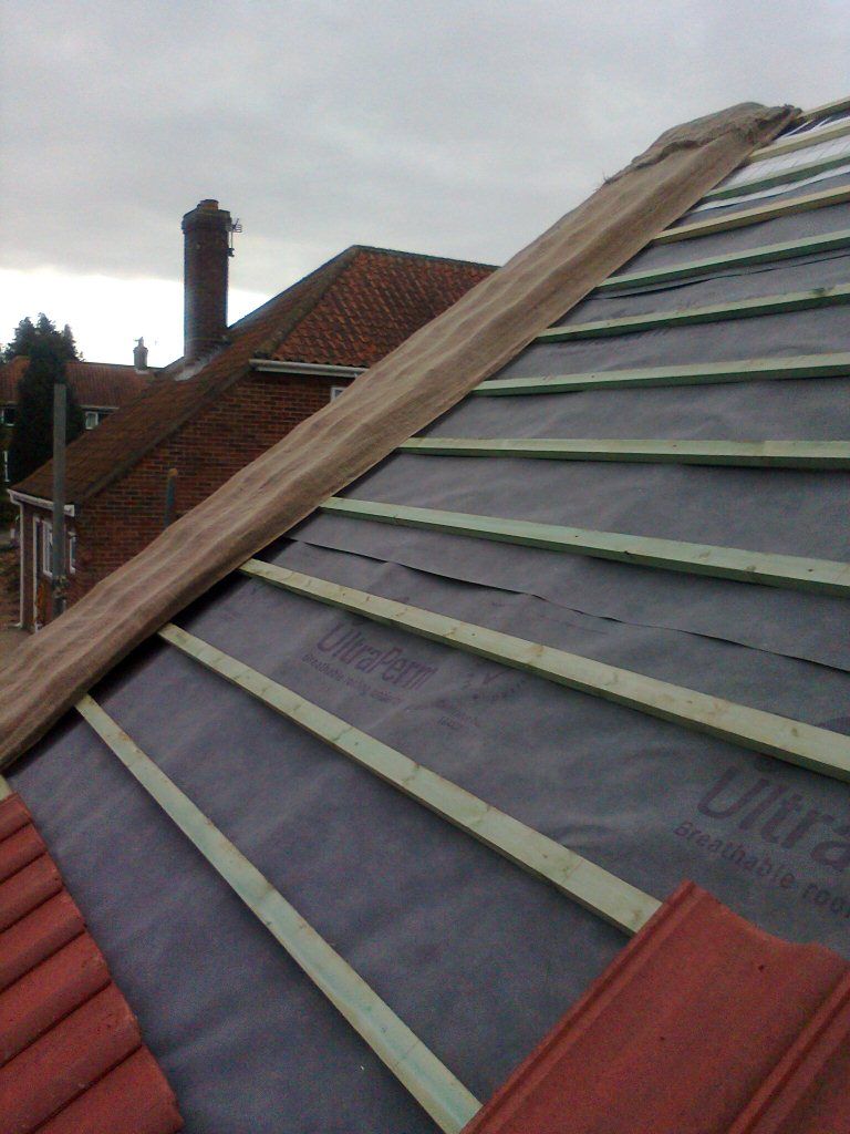

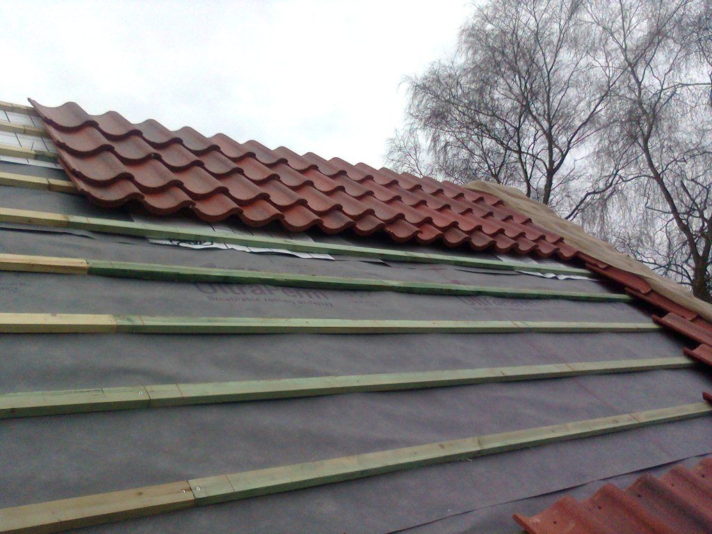

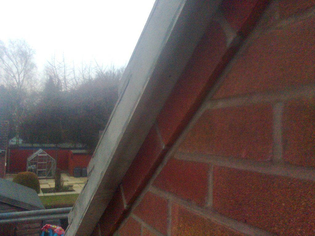

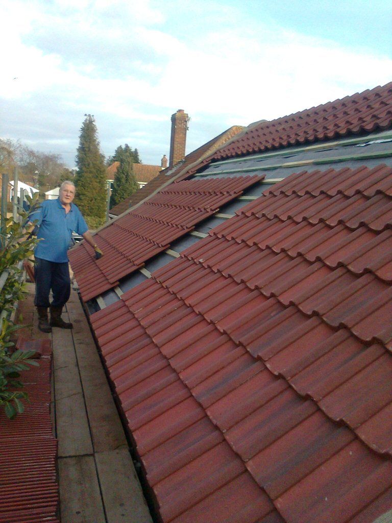

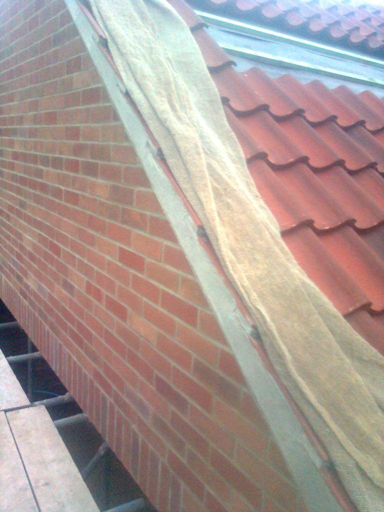

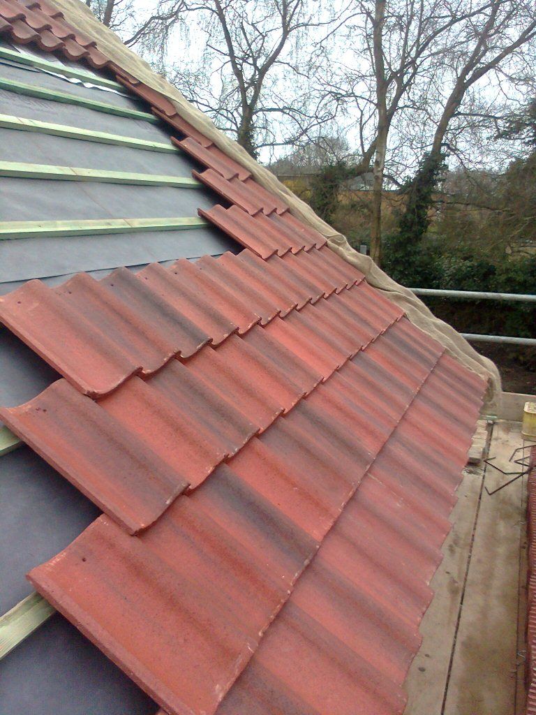

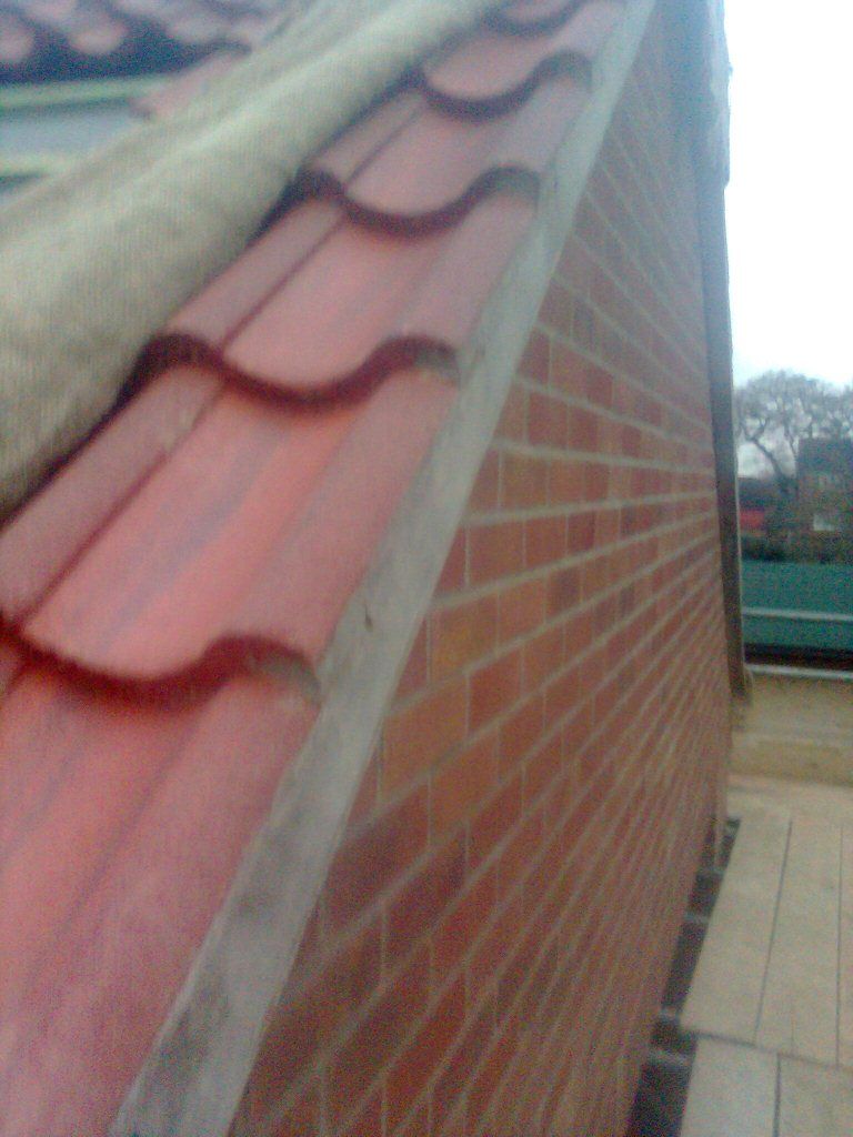

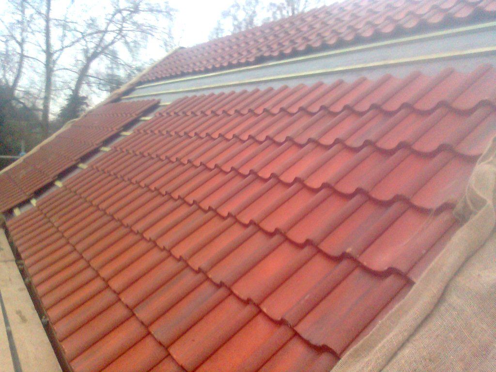

UPDATE:

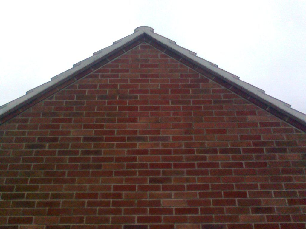

We finally got a long awaited break in the weather last Friday!  So on Friday we got the verge tiles bedded on and the verge details done....

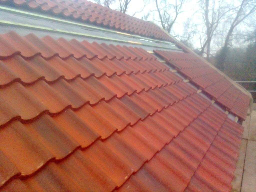

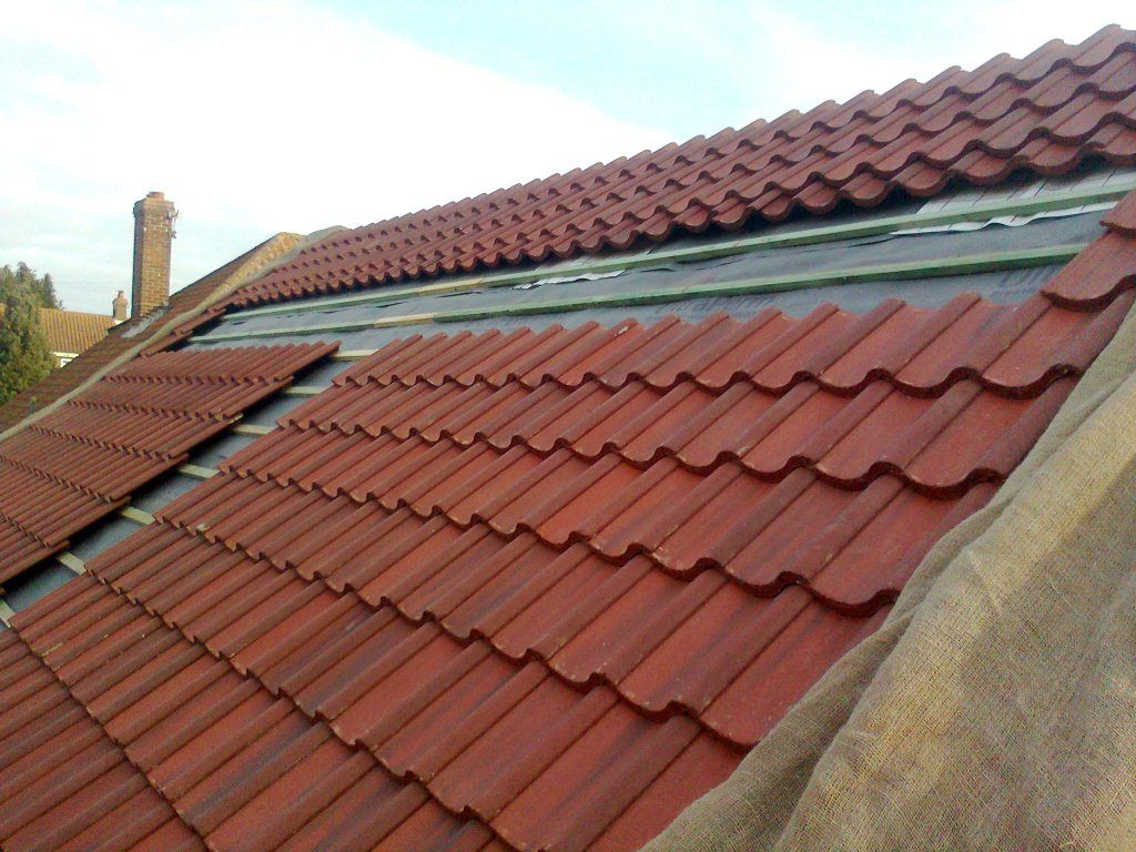

Then over the weekend I laid the majority of the tiles, leaving a 'T' to allow access for laying the ridge tiles...
Even managed to rope my dad into doing some labouring for me!  ;D
This is what it looked like on Monday morning...
More to come...  :y

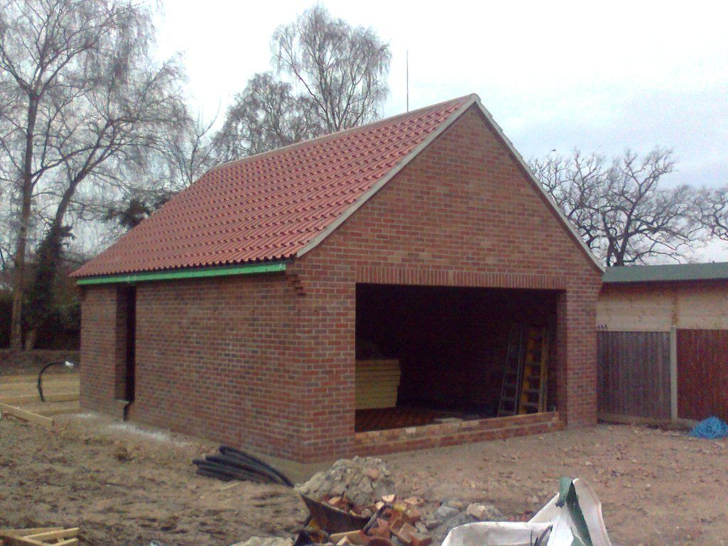

« Reply #103 on: 22 February 2013, 08:41:49 »

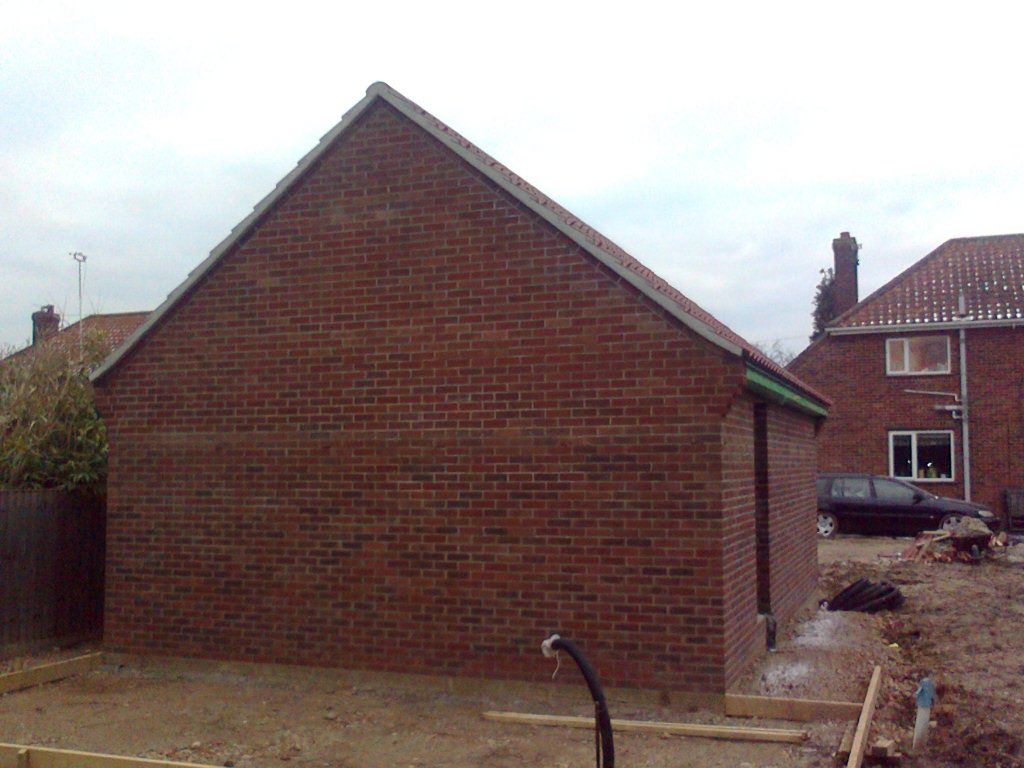

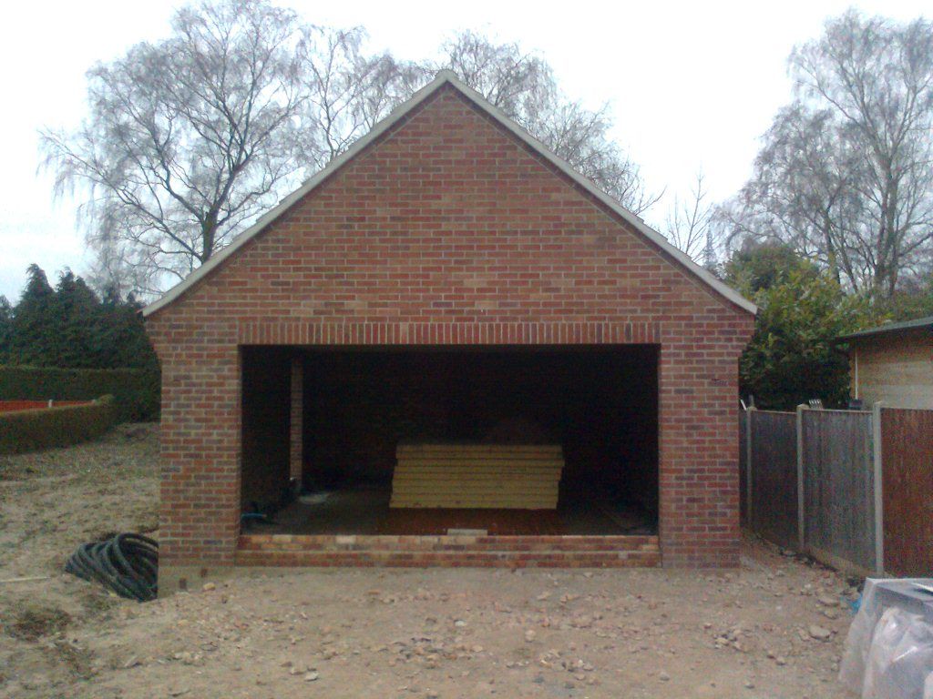

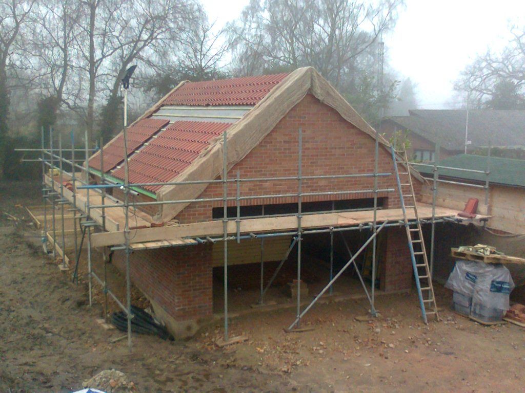

On Monday, we got all the ridge tiles bedded, and laid the last of the tiles, filling in the 'T' as we came down.  We also built up the brickwork at the front of the garage.  This will only remain in place until the concrete floor is laid, and will then be broken away, so that the driveway will run up to the floor between the piers of the door opening.
On Wednesday, the scaffold was struck, and for the first time I can now see it properly!  ;D
Next step will be getting the doors installed, and the the concrete floor!  :y
